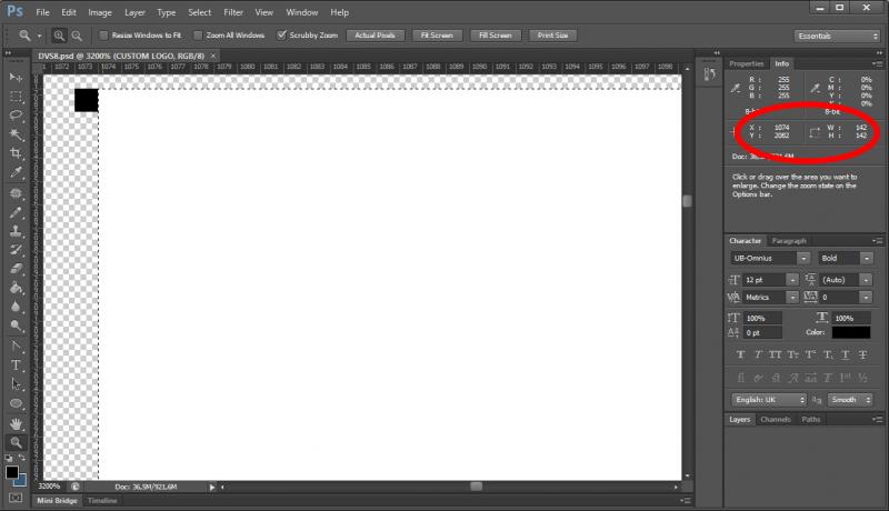

I just wanted to know if there a program which you can use to create skins.
I thought it would be nice to create one myself.
The code isn't a problem but match the picture would be.
I would need a code that was able to tell me the x and y to input for location (I think)
I still use the old skin creator for this.
It doesn't help for code - but object positioning it works well.
Is there any other way around this??
I don't think Bob or Phantom even use the creator, lol!
This has always been where I struggled as well. Finding the X/Y placement.
Posted Thu 05 May 16 @ 3:56 pm
You also do it in your graphic editing software.
I've just always used SC and its worked for me.
Posted Thu 05 May 16 @ 4:15 pm
What program is that?
Posted Thu 05 May 16 @ 5:32 pm
Its Photoshop by the look of it.
