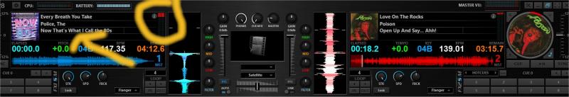

Why this particular button make the "Button name dissapear when activated ? The other buttons the just turns white when activated but not the 7th one as in the pic attach with the arrow pointing to it.
Posted Tue 09 Aug 16 @ 3:20 pm
ok, I was looking at the XML file and saw this
<textselected action="custom_button_name 7"/>
that 7 should be 30
Now is all good.

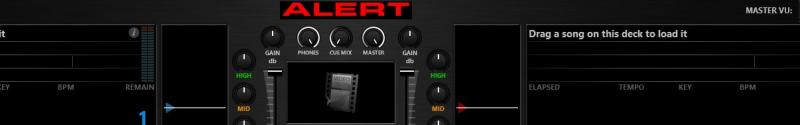

Can I request a feature ?
It happened today. I had a gig mid afternoon outside. Everyrhing is going well until close to 2 hours into the gig.
Then sound stutters, skin freezing etc..... and wondered what the heck is happening. I figured maybe CPU was getting hot.
Anyway, about 1 minute of quick connection check, I saw that the AC adapter was not active, the AC adapter was HOT ! ! ! ! and I was RUNNING my gig laptop on Battery power. I check the battery level and it was so slow causing all sort of problem.
Anyway, got my spare AC Adapter and plug it is and back to business for the rest of the gig.
My request is, can we have a RED FLASHING ALERT all the time when AC adapter is cut off ? I am talking about a BIG READ ALERT BAR somewhere maybe on TOP

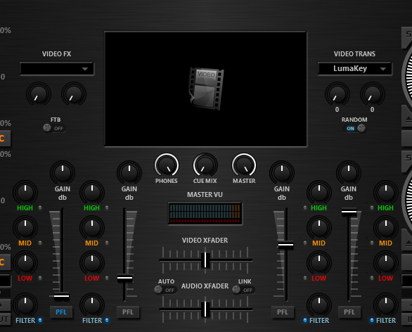

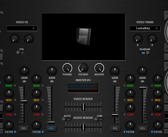

Mixer order on SilverSleek #3 follows your current setting.
So, while there's no "button" or menu to change mixer order from within SilverSleek #3, the skin WILL show the correct mixer order automatically.
If you wish to change mixer order on the fly from within SilverSleek #3 use a custom button with the following code:
mixer_order 3124 ? mixer_order 1234 : mixer_order 3124
3124:
1234:
Please notice how the fader curve graphics also change between 3124 and 1234... ;)

Just tried your script. Works perfect! Now the video, faders and crossfader work perfect together with my external mixer, xdj's, vdj and audio.
Really wonderfull to have the different fader curve graphic!!
I can see immediately which setting I have activated!
Thanks for your help.

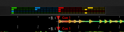

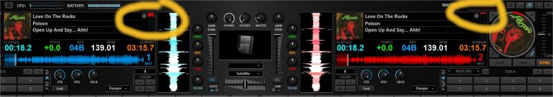

This one will pass by with everyone until you have notice it at the right time.
I think it is just related to SS#3.
Anyway, here are pictures of it.
To test: While playing a song, perfectly time it to pause exactly when it hits the red mark. You will notice that it will stay there and not clears up (falls down).
Even loading a new song to the deck, that red mark stays there until of course you press play.
See that first screen shot. I timed that song on both deck to pause on the red mark.
The second screen shot is when I loaded a different song and the red mark stays.

Trust me, I know this "bug" but it's not related to the skin itself...
Perhaps I can do some work-around to eliminate it if that's so much of a big deal...
Background technical details:
The RED bar shows the limiter. In this photo case it shows the limiter of the particular deck.
The problem is that as soon as you stop the deck, there are a few rare cases that the "get_limiter" action can stuck to the last reported value until you do anything on the deck that may produce noise (and thus force the vu-meters to recalculate themselves).
