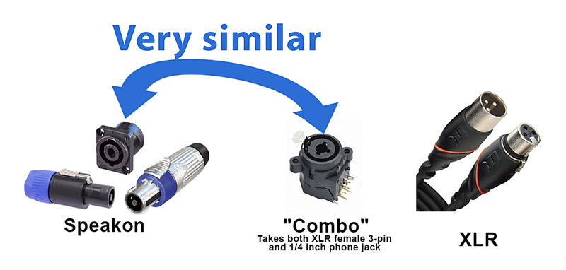

I'm with locodog on this -- Speakons are intended for running between an amplifier and a speaker.
The input jack of a speakon connection could be confused for a similar item called a Combo.
The Combo takes either an XLR or 1/4 inch phone plug. You can tell the difference by looking at the center hole-- Combo has three notches take out-- Speakon has smooth round hold with no notches taken out.
Like locodog said-- link the speakers you are looking at. :)

http://www.briostudio.com.my/onlinestore/images/behringer-b-208-d-malaysia.jpg
sorry for the confusion!!

the speaker in the picture have 1/4 inch and XLR inputs
i would run 1/4 inch cable to your RCA and buy 1/4 to RCA adapter plugs like this -> http://www.sweetwater.com/store/detail/GPR104
the 1/4" cable will handle the distance better then RCA cable and it will be better shielded. something like this -> http://www.zzounds.com/item--HOSHSS?siid=122433
