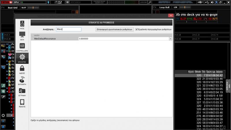

Have you tried adjusting the filter it has settings see -> filterDefaultResonance in audio options make sure u have ticked advanced

there is also the costum setting
I have put the value
filterDefaultResonance 0.8

from another post I
SBDJ wrote :
It takes a numerical value.
Subtle = 0.2
Default = 0.5
Strong = 0.95
Subtle = 0.2
Default = 0.5
Strong = 0.95

I agree 0.8 would be ideal too. My setting option for filter is Default, Strong and Subtle, how do you get the decimal /numerical value option? I am using v2857.1116
Posted Mon 14 Mar 16 @ 6:47 pm
Just type over the words in the box
