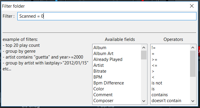

However, the new issue I have is with creating a filter folder that works properly. On the previous version(s) I could create a "Not scanned" folder for each root and just click on that and do a batch scan for any new files I added. However, no matter what I do the filter folder always goes to the bottom of the folder list so is not actually contained within any folders and I cannot move it. I thought this was going to be fine and would simply scan all folders and subfolders but it doesn't. It only picks up files within the first level of folders and not their subfolders.

The scope is probably set to folder.
Do the following, Edit a filter folder and at the top right corner of the edit window should be a drop down box.
Choose "folder (recurse)" and you should be fine.
Alternatively choose "database" as the scope.

There are no drop downs when I go to edit a filter folder. I know there used to be, that's my issue.

if the filter folder is in the root of all folders there is no drop down
if it is in a sub folder you will get the drop down

I believe the action for that filter folder should be:
isscanned = 0
isscanned = 0
