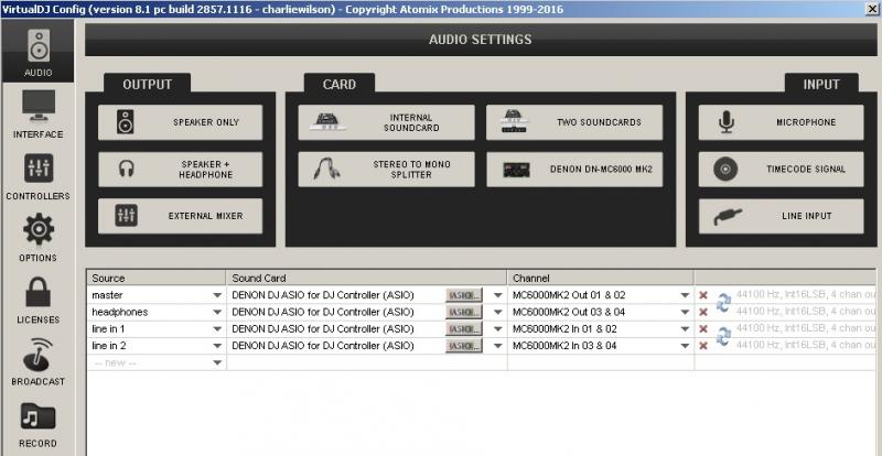

I recently upgraded from 7 to 8. I have been using it for a few months and yesterday was the first issue I have had getting the controller to function.
I get the message "Virtual DJ - No sound card. *DENON DJ ASIO for DJ Controller Failed to create ASIO Buffers".

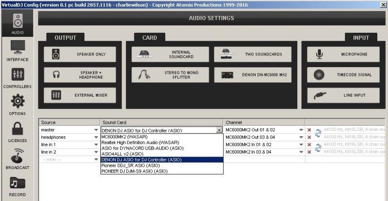

I have 3 Sound Card options:
1. DENON DJ ASIO for DJ Controller (ASIO)
2. MC6000MK2 (WASAP)
3. Numark USB Audio Device (ASIO)
I don't know if I should use 1 or 2 with the MC6000MK2. I only use the Numark if I would have to connect to my old DENON mixing Board.
I could get both microphones and audio to go through the board but it's the first time the board would not function. I had to do a big show using the mouse and laptop and the master gain on the board

There does seem to be problems with this controller and VDJ, myself and a friend of mine are having troubles too with our mk2's. Check this youtube video to see if it helps.
Perhaps someone could confirm whether the following settings are correct?
Posted Mon 22 Feb 16 @ 7:54 pm
I never did get confirmation about the setting and whether they were right or not? its a popular controller i thought someone would chip in.
Posted Thu 03 Mar 16 @ 9:20 am
As it's a natively supported controller and has its own dedicated setup button when it's auto detected, I would imagine that the settings configured when you press that button are the correct ones.
Also see the official Atomix documentation - http://www.virtualdj.com/documents/Denon%20MC6000MKII%20-%20VirtualDJ%208%20Operation%20Guide.pdf
Posted Mon 07 Mar 16 @ 5:46 pm
