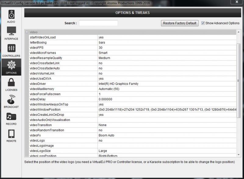

Played perfectly first time in VDJ on my laptop using the on-chip Intel graphics. I then swapped over to the AMD Radeon HD 6630M and it played on that card too.
Must be something to do with your configuration or video drivers.
Here is my video config:
Posted Thu 03 Mar 16 @ 10:06 am

Videoforcefullscreen I've set to 1. Mine was on 0.
Also changed Videomaxmemory to Auto. Mine was on 256 for some reason.
Seems to have fixed it!!! So far.
Something so simple!
