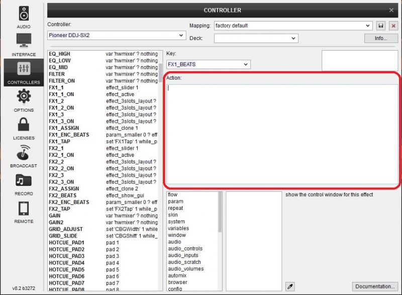

Have tried to modify the factory mapping with version 8.2 b3272.
And this copy/paste is not working.

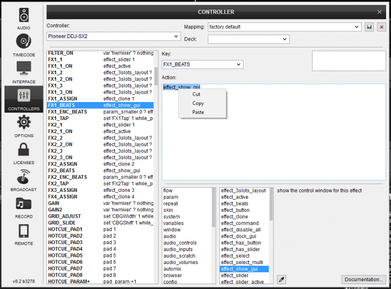

Copy/paste working fine here, could you be more specific?
Posted Wed 22 Jun 16 @ 4:22 pm
When Im in the settings for the controler ddjsx2 I cant copy the script from phantom and paste it into the window.
This worked fine before, now I can not copy anything and put it into that window.

It's working OK here, I can use the right click context menu or Ctrl+C/Ctrl+X/Ctrl+V.
Posted Thu 23 Jun 16 @ 9:13 pm
Right click wont work.
But using ctrl/v works..thank you !
