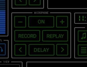

I have assigned my third deck to the microphone input (linein) to be able to record and playback the mic.
In VDJ7 these buttons functioned as intended:
This button turns the mic on and off:
<button action="linein & volume 100%">
<size width="93" height="45"/>
<pos x="741" y="435"/>
<up x="741" y="435"/>
<selected x="900" y="1349"/>
</button>
This button turns the input recording on and off:
<button action="linein_rec">
<pos x="692" y="484"/>
<up x="692" y="484"/>
<selected x="853" y="1411"/>
</button>
This button play the recorded sound while pressed:
<button action="play while_pressed & play ? on : off">
<pos x="789" y="484"/>
<up x="789" y="484"/>
<down x="951" y="1411"/>
</button>
In VDJ8 the play button will light up when turning on the microphone (linein). That's a strange behaviour.
Furthermore, after recording my voice, the microphone cannot be turned on again. Very strange behaviour.
The above mentioned buttons are placed inside the deck container.
Can anyone shed some light on these peculiar problems?

Posted Mon 25 Jan 16 @ 11:35 am
For starters this: <button action="play while_pressed & play ? on : off"> can be changed to this in version 8:
<button action="play while_pressed" query="play">
This means that in version 8 you can specify a different action for the button and a different condition for the graphics to turn on:
<button action="play while_pressed" query="line_in ? off : play">
Also on VirtualDj 8 once you have something recorded on a deck you need to unload it before you can re-enable input or record again.
So you need to change your "record" button to this:
<button action="linein_rec ? linein_rec : unload & linein & linein_rec" query="linein_rec">
Hope this helps
Hope this helps
Posted Mon 25 Jan 16 @ 1:49 pm
Appreciate the input, George!
I'm not so happy with the way the recording and replaying is going in VDJ8. The playback is waaay louder than the actual mic volume. And all three buttons light up when recording (can't get them to light up independently, as in VDJ7). And I can't record something, then use the microphone again and then play back the recorded sample (because the deck has to be cleared first)... No such problems in VDJ7 that i can remember...
This is what I have now:
<button action="toggle '$MIC' & var '$MIC' ? unload & linein : linein" query="linein">
<button action="toggle '$REC' & var '$REC' ? unload & linein_rec : linein_rec" query="linein_rec">
I'll experiment a bit more...
Posted Mon 25 Jan 16 @ 3:50 pm
I've seperated the unload command from the others...
... having to push the "clear" button to switch from recording to talking (mic)... don't like that much, to be honest...
...but things are a bit better. The MIC button still lights up when recording, but I guess that can't be helped... What bothers me (a lot) is the difference in volume between the mic and the recording of the mic (much louder). Is there a code for the linein recording volume?
Posted Mon 25 Jan 16 @ 4:17 pm

I understand what you are saying, and I'm pretty sure my lack of scripting knowledge makes me write unneccessarily complicated codes sometimes.
Having said that, I think you misunderstood what I was trying to do... Again, thank you so much for trying to help me.
What I need is a button to turn the linein on and off. It's that simple. Or is it? Well, as it turns out, in VDJ8 it isn't that simple anymore. Now you've got to unload the deck your linein is on, because otherwise you can't turn the linein on. And when you unload the deck, any effect that was running gets turned off, of course... So you need to unload and re-activate any running effect, when turning on the linein.
I don't use "mic" because I never could get that to work. I have my microphone connected to a (custom built-in) microphone amplifier (with phantom power supply), which in turn is connected to a linein of my sound card. So I need to activate the linein to have the microphone working...
Back to my mic button. This is what I have now:
<button action="linein_rec ? off : toggle '$MIC' & var '$MIC' ? off & effect_active 'echo' ? unload & volume 100% & linein & effect_active 'echo' : unload & volume 100% & linein : on & effect_active 'echo' ? linein & effect_active 'echo' : linein">
linein_rec ? off = to make sure the button doesn't light up when recording: It's the mic on/off button, not the mic rec button, after all! (For some strange reason VDJ8 turns it on when recording or playing back :( which I find terribly confusing)
toggle '$MIC' & var '$MIC' ? = just my way of making sure the button lights up when it should. Query doesn't always work for me, but that may be because I don't know all the syntax possibilities of this new verb...
effect_active 'echo' ? unload & volume 100% & linein & effect_active 'echo' : unload & volume 100% & linein = unload the deck and turn on the linein... and if the echo effect is turned on, keep it on!
effect_active 'echo' ? linein & effect_active 'echo' : linein = turn of the linein, and if the echo effect is on, leave it on.
It's not perfect yet, but I'm getting there. The replay button still lights up when I turn on the microphone linein.
You are correct. I also found out that in VDJ8 the linein does not have to be activated to be able to record.
And again: thank you for all your effort!!! Appreciating that!!!
P.S.
My linein (microphone) runs on a dedicated deck: deck 3. All code is inside that deck container.
P.S.
Posted Tue 26 Jan 16 @ 9:37 am
Just to make sure, I've tried the query verb again, but it doesn't work... Maybe I'm not using it right?
<button action="toggle '$MIC' & var '$MIC' ? effect_active 'echo' ? unload & volume 100% & linein & effect_active 'echo' : unload & volume 100% & linein : effect_active 'echo' ? linein & effect_active 'echo' : linein" query="linein">
<button action="linein_rec ? linein_rec : unload & linein_rec" query="linein_rec">
When the linein button is pressed, the play button also lights up. And when the record button is pressed, both the mic and play buttons light up. I'll try the old way and see if I can get what I need, namely that buttons only light up when they have been pressed. I'll let you know when I arrive at a good code for that.
Posted Tue 26 Jan 16 @ 10:00 am
I'VE GOT IT!!!
This way the buttons only light up when pressed:
<button action="toggle '$MIC' & var '$MIC' ? off & effect_active 'echo' ? unload & volume 100% & linein & effect_active 'echo' : unload & volume 100% & linein : effect_active 'echo' ? linein & effect_active 'echo' : on & linein">
<button action="toggle '$REC' & var '$REC' ? off & unload & linein_rec : on & linein_rec">
<button action="linein ? off : linein_rec ? off : play while_pressed">
Posted Tue 26 Jan 16 @ 10:30 am
