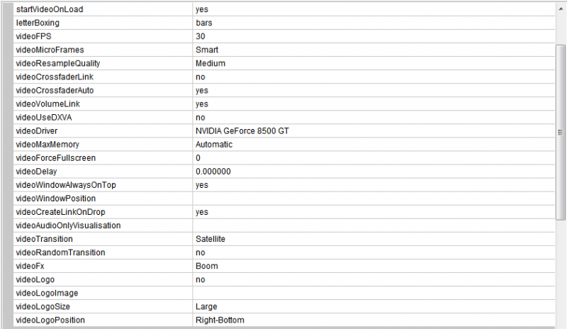

Here's a shot of my settings when playing vids on my desktop through v8.

DirectX 9 is available on any recent version of windows without installing anything. Only for the Milkdrop plugin you may need to install some additional files.
VirtualDJ itself also don't require to install any of the visual c runtimes.
One thing that does affect the performance is the drivers of your video card, so check the manufacturers website to see if updated drivers are available.
In VirtualDJ 8 itself, you can try to enable the option useDXVA in advanced settings. This offloads decoding to the graphics card, which should give better performance.

Adion I did enable the DVXA and it seemed to help to cure the problem. Thank You.
