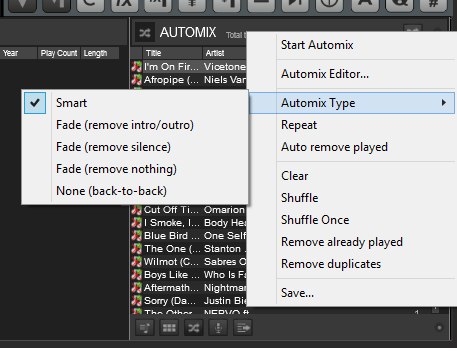

I don't think that is a remote "problem".
I think you should set the fading option in the automix menu.
Posted Wed 16 Dec 15 @ 12:10 pm
Thanks, I tried changing those and they don't seem to make a difference on the remote app. When I hit the wand icon on the remote app it does shift from the playing deck to the non playing deck but it also adjusts the tempo of the track as if sync was on which I don't want. I just want to simply fade from deck A to deck B and vise versa without any speed changes to my songs.
Posted Wed 16 Dec 15 @ 2:02 pm
Try the bottom setting: None (back to back). If you haven't already tried it.
Posted Wed 16 Dec 15 @ 2:08 pm
Ahh, cool, that's the one I haven't tried yet. I will give it a go tonight.
