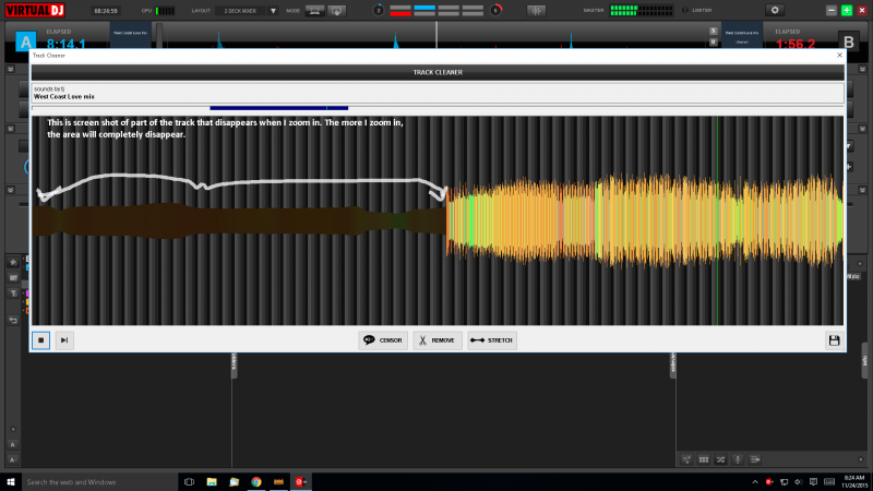

When I'm trying to use Track Cleaner to remove certain parts of a song, I zoom in to get accurate start points and end points to delete, but when I zoom in on longer songs, parts of the track disappear. I can't seem to figure this problem out? Anyway, someone can help me out with this?

This particular track is an hour long... but I dont get why the length would matter... it happens in different areas, for a reference, it might be like 20 minutes in, then be fine where I can zoom perfectly, then again a little later.

I have that already taken care of so that wasn't the issue... any other ideas?
