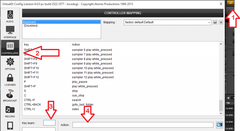

Hi, I assume you mean keyboard mapping,
1 go to config
2 go to controllers
3 click here and press the key you want to use, the key will appear in the box below, click it.
4 type scripts here.
Repeat stages 3 & 4 for every key
Here are the scripts you want to use.
If you want to use 8 keys (4 keys for each deck)
deck 1 filter -2%
deck 1 filter +2%
deck 2 filter -2%
deck 2 filter +2%
deck 1 eq_mid -2%
deck 1 eq_mid +2%
deck 2 eq_mid -2%
deck 2 eq_mid +2%
If you only want to use 4 keys and only adjust the "selected "deck (selected deck is switched by tab)
filter -2%
filter +2%
eq_mid -2%
eq_mid +2%
1 go to config
2 go to controllers
deck 1 filter -2%
deck 1 filter +2%
deck 2 filter -2%
deck 2 filter +2%
deck 1 eq_mid -2%
deck 1 eq_mid +2%
deck 2 eq_mid -2%
deck 2 eq_mid +2%
filter -2%
filter +2%
eq_mid -2%
eq_mid +2%
