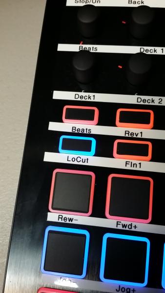

I use this controller with my VDJ Pro Version 7. I have it all mapped to do what I need it to do.
I've mapped each side with a Low Cut button, which decreases the Low_Eq by 10% each time it's pressed. (Four hits takes the low down to nothing). Works well when a crossfade is a little to "heavy".
Regarding the LED function, is there a way to add a command that would assign/change the "blink rate" depending on how many times the button has been pushed for the track playing? Something like....

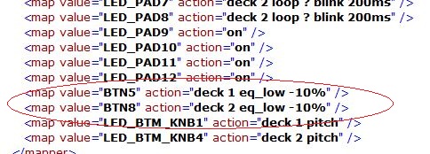

That would be awesome! Here's the instruction for the button...

I see what you're doing there. Rather than base a blink command on how many button pushes, you're basing it on the actual value of the control.
I'll give it a try and report back...

Got it! The exact code you gave didn't work, but I did some digging and discovered that the percentage perceived by the system and what was displayed on the screen weren't the same (probably a rounding issue). When I fiddled with neighboring values and found what it wanted, it worked!
deck 1 eq_low 40.02% ? blink 1000ms : deck 1 eq_low 30.04% ? blink 500ms : deck 1 eq_low 20.05% ? blink 250ms : deck 1 eq_low 10.06% ? blink 125ms : off
