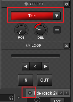

This is a relatively minor bug but I hate to say 'minor' since the whole visualization implementation is a bug in my opinion. I assume the code is just as confused as the user interface is :)
I am using the VDJ8 2 deck default skin. build 2522
1) select something as the visualization. It does not matter what but I used slideshow.
2) place a video on deck 1 or activate a video effect on deck 1. Slideshow is now active on deck 2
3) bring up the user interface for slideshow on deck 2 and this is a must.
4) select a video effect different from slideshow on deck 2 and activate it. Does not matter what video effect but I used title.
Now you will see title is selected on deck 2 and activated. You will see the slideshow user interface is up on deck 2. You have some video or video effect active on deck 1. Click on title to deactivate it. The slideshow UI will go away and title will deactivate as it is supposed to but the skin is still showing it as activated as seen below. It gives the impression that nothing happened when you try to deactivate Title but it did work. Just the skin indicates it did not.
More later. Easy to get burned out on the crappy visualization implementation.

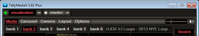

It is uncomplicated if you don't care about how it works or you don't do anything like most plugins but it does not make it right. Most don't even know what is going on so how could they complain? I have enough trouble trying to explain it :) This whole story goes deeper than you realize but that's ok if you don't have a clue or care. Have you tested your own stuff lately? The real problem I have is there seemed to be no design for it prior to release and so you patched something in. Was probably too late to do anything reasonable with the skins and I do know about pressure to ship. You had about 3 years I think to design it didn't you?
Also not about attacking anyone. I among 1000s of others had high expectations for 8. I was a fan of the group that developed 7 but you can only throw so much crap at someone. I am still a fan but not as much but still have good respect for some at Atomix. I am mostly about working and getting things done and not complaining, and would very much like to say 'great job'.
Ok I said I had some questions. You have added things that don't seem to know what a visualization is. This apparently comes directly from the design or lack of one.
For example:
effect_show_gui "audioonlyvisualisation"
effect_select "audioonlyvisualisation"
I don't believe any of these actually work unless the visualization is active. Correct? So why would you add them if there is just going to be more confusion? The funny thing is that for some reason it makes perfect sense to add something that makes no sense to something that makes no sense haha... Sitting here laughing about it. You see I smile a lot but you can't see that in my words sometimes. They seem cold to me but that is the nature of coding and trying to explain things. I suppose they might work as expected some day.
I think it should be real easy for you to tell a plugin that a visualization instance is being loaded. That is, you must already know. How could you not know lol. I can tell you how you might not know but then you think for some unknown reason that this thing is clean I guess. If you want to add anything about audioonlyvisualisation then add something that works for pete's sake. You must know, because you just have to, but GetInfo master always returns true during every method except OnDraw for a visualization. Must be being loaded and managed on the master? Not even OnStart works for get master. Only in OnDraw do you get correct behavior and why your attempt to add audioonlyvisualsation script in part fails but goes beyond that I am sure. If you want to add something that works, then add something that tells you in any method that this is a frekin visualization instance. This is not much to ask for. Like GetInfo ("get_deck 'audioonlyvisualisation' ? true : false",&query); which would be similar to master and better set you up for the long run. Scott mentioned this: "I have added to the next build a new script command 'is_audioonlyvisualisation'". Is this just one of the things that don't work unless activated or does it actually work in all cases? I don't believe it has been added yet but that would be good if it actually worked but I don't think it can. That is you don't know it is potentially a vis instance at the time of loading. Sometimes you do but sometimes you don't know.
Now if you have a plugin that uses the VDJ interface and not a custom one, the deck or master is changed on the fly as the vis moves around. This can only be known in OnDraw as I see it. This is automatic for a plugin that is using the native user interface system. It is not automatic for a plugin that is not using the native UI. Oh yeah, I can poll in the OnDraw call to find out but this leads to next question.
First and can't say it enough, the should be a real deterministic way to determine if an instance is actually an audio only vis in any method of the instance but may be impossible because of design . If I have to though I will poll for it in OnDraw which I guess matches the built in clumsiness. In OnDraw now GetInfo ('master') works. Now I can determine the actual deck but must also ask what is on the left deck and the right deck to make a correct detection that this is the real audio only vis.
To determine the actual deck for a vis for a non native UI plugin I must do this currently in OnDraw:
1) find out the actual deck or master it is on.
2) check what is on the left deck and right deck. You can use is_video to determine if video is on either deck. But is_video does not tell you if a video effect is active on left or right deck. Having an active video effect on some deck that is not the vis is same is having a video on that deck as far as audio only vis detection goes. This is only true though for a plugin that sets the VDJFLAG_VIDEO_VISUALISATION in OnGetPluginInfo. By the way impossible to change this behavior on the fly or any flag that can be set only in OnGetPlugInfo... Not so good either.
Laughable you say it is uncomplicated lol... But of course you made something that should be very easy both internal and from user's perspective into a complicated mess. What? You want me to sugar coat it or something lol...
Ok now what is the syntax for determining if also a video effect is active on a deck that has the VDJFLAG_VIDEO_VISUALISATION set? As is usual when I have to do something like this, it appears to be undocumented.

Thanks for looking into things. I will take a look at what you have changed when we get the next update.
Another issue may be when you become the audio only vis or when you stop being the audio only vis. That is user is changing the audio only vis in config. You could check but leads to some manual polling in various places. Could be useful to show in UI to better indicate what is going on.
When an effect is selected or you just bring up the UI and not active, currently you do not know if that will become the actual audio only vis. You do know if you are selected though as the audio only vis at load time though. It may be I will disallow some things depending on some of the details about this. Some things don't make any sense to a user because they do things without knowing and why would they. All they see is it is there and should make sense but like it does not make sense to do things that are just going be dumped anyway depending on how the audio only vis is moving around. If they never did these things I would not bring it up but it is just to easy for them to create difficulty with this and so they can become confused about it.

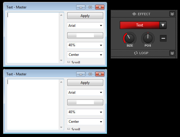

Just some more evidence for you how things can be confused. Using text effect as audio only vis. The text effect has a non native UI and below shows it is confused which is natural because the audio only vis implementation is poor. One is on the master and one is on deck 2. They are not both on the master as indicated in the caption bar.

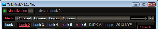

Might as well throw this into the mix of problems while we are at it.
Audio only visualizations become active when the video screen is up and there is no video on the left and right decks. If an audio only vis has been made active by the given rules, it remains active if the video screen has been hidden. All that happens in this case is OnDraw is not called. All the threads that the plugin may be using are still active and processing and doing their thing. That is because OnStop has not been called. You don't seem to have any problem calling OnStop and OnStart when not needed but you seem you have a problem calling OnStop when it is needed in this case. Not to big a deal but just more BS. If the video screen is up and there is video in both the left and right decks then it does become inactive. Kind of strange there is a difference here don't you think?
