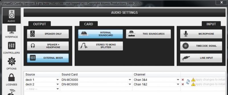

If you are using the Denon ASIO drivers that could be the culprit. Try using WDM (WASAPI) instead. Seems to have cured the issues on my DDJ-SX2 although I have only done one gig since changing. I used my MC6000 this weekend for two gigs with the WDM drivers and had no problem at all.

Set your sound config to select MC6000 drivers and not Asio. this is for external mode.

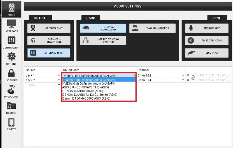

what drivers are those, all my denon ones are asio and build 1072 what one is that http://www.virtualdj.com/wiki/VirtualDJv8.0builds.html

kradcliffe How do you have yours showing Denon MC6000 but not Denon asio Drivers

Those are the drivers Windows creates when the device installs on the PC.

What when you connect the MC 6000?
Strange i don't have them then. Maybe because i installed the asio to start with?
I,m assuming you have not installed any asio drivers then from Denon
