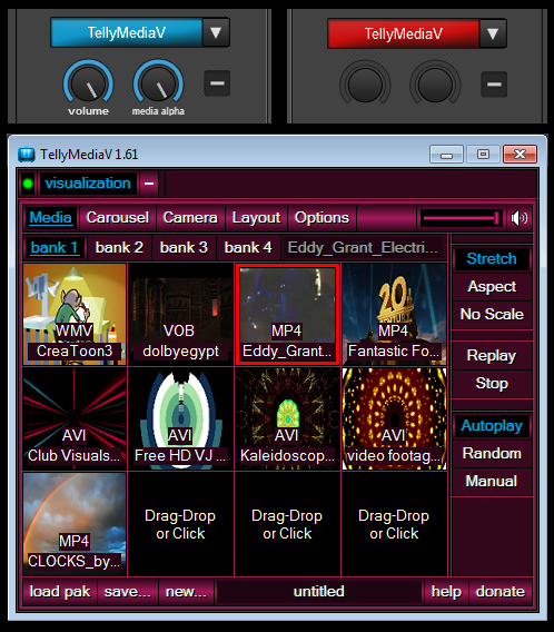

I have TellyMediaV running as audio only vis. It is on master. You can see below that TellyMediaV is also active on the left deck and right deck. It will be shown active on master as well. Then is only one real active instance though. You can also see the interface buttons are at minus indicating the interface is up for each. Then you will notice there is only one interface up called visualization. Internally TM is tracking all instances and making it behave as expected. Expected behavior is open to interpretation currently :) You will notice the dials are not set on the right deck but that is no big deal and just did not bother with it for now. Knowing that it is a visualization means I can automatically disable any audio as well if any. In this case TM does not care where the hell VDJ thinks it should be. It is forcing compliance which it should not have to do.
