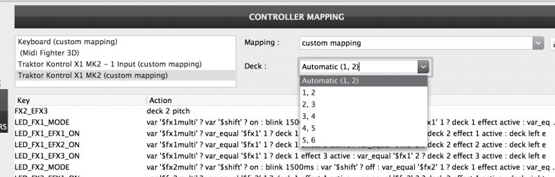

Actually not an option. When I type it in manually, it reverts every time.
See attached scree shot.
