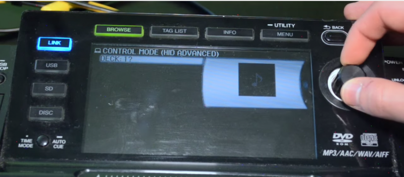

I am having an issue where when you connect the pioneer decks in HID mode, decks 1 controls decks 2 on VDJ and decks 2 controls deck 1. Is there an option to swap them around. In settings I see where it suggests it's possible but it doesn't make a difference. Sometimes only 1 deck gives sound even though i'm still able to control it. Does anyone know of an updated guide to connect CDJ decks to VDJ in HID mode?
This option doesn't show up when connecting decks with virtual dj but does come up in serato and traktor

          Is on my whishes-thread. I think there is no solution. Putting on CDJ's is always a lot of work.
But I didn't get any reaction....

          You can specify which CDJ controls which deck in the Controllers window of VDJ config.

Yes, I know... but you have to do this all the time on my mac. Or 1&2 are reversed, or the sound is reversed.. There is always something wrong.
Why not as RB? Just ask on the cdj the deck it has to control when turning on the cdj....
