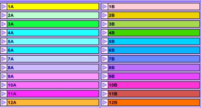

I hope the above image clears up what I meant. Yes Groovin it's the tracks key to have its discrete colour for additional visual presentation.

Are you aware that you can set a colour for tracks in the VDJ 8 browser?
....or maybe you are asking for VDJ 8 to automatically colour the track when it scans and detects the key? That's not possible at the moment.

you could use filter like
key is "01A" and exists = 1
then select all the tracks and set a colour for those tracks
Posted Mon 26 Oct 15 @ 8:47 pm
There is also a command browsed_file_color that can be assigned to a custom button.
You can use this with HTML color hex codes, for example browsed_file_color "#ff00aa" so it would be possible to:
1 find the hex codes for the colors in your chart
2 use browsed_file_color to set the colors for the keys
So you could have 24 custom buttons, named for each Camelot key, with a script that sets the required color.
This is exactly what I meant.

Well, it's only 24 cases.
You can create 24 textzones for instance, set their visibility according to loaded track's key and use the textzones color propertie to paint the text.
<textzone visibility="param_equal '`get_text '%Pcamelot'`' '01A' ">
<pos x="" y=""/>
<size width="" height=""/>
<text color="#bebebe" format="%Pcamelot"/>
</textzone>
<textzone visibility="param_equal '`get_text '%Pcamelot'`' '02A' ">
<pos x="" y=""/>
<text color="#beeeee" format="%Pcamelot"/>
</textzone>
<textzone visibility="param_equal '`get_text '%Pcamelot'`' '03A' ">
<pos x="" y=""/>
<text color="#befefe" format="%Pcamelot"/>
</textzone>
etc

That's a good idea, I like that!
I was thinking along the lines of having the image he posted (the keys & colors) pop up in a window.
