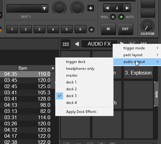

Hi. When I'm using vdj 8 and I activate any of the sampler sound effects, they come through the headphones as well as my main output speakers. Is there a way to stop the sound effects from coming through the headphones? I've looked in the settings but I don't seem to see any way to change it. Thanks in advance.

In case you are using a Master & Headphones audio configuration, your best option is to use a spare deck (e.g. use the 4 Decks skin) and send Sampler to a Deck.

Thanks for replying. Yes I am using the master & headphone configuration. I don't really want to use the 4 deck skin but I will give it a try anyway. Thanks again.

If you still want to use a 2 Decks skin and have the option to assign Sampler to a later deck, you will need to edit the XML file of the skin you are using and have for the 1st line of the skin nddecks="4". so it will look like this..
<skin name="" ........... nbdecks="4" .... >
