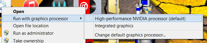

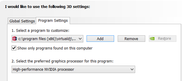

Ok I have all my video related programs to use my Nvidia card,
Heres a pic from the Nvidia control panel showing VDJ is supposed to run on the graphics card

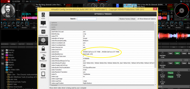

Heres an image showing VDJ has the Nvidia card selected as the default card,
Yet when I launch VDJ and open the video tab, look what VDJ says its using,
Is this some sort of bug and how do I find out what card VDJ is really using??

When I change it from the nVidia control panel and restart vdj the drivername shown in vdj changes as well.
Another way to check is to check 'Desktop->Display GPU activity icon' in the nVidia control panel, then click the icon in the system tray and see if it shows virtualdj.
Finally, you should be able to tell by the performance difference. (Although that will depend on your cpu, for me the Intel HD4600 of my core i7 is fast enough for video so I don't even need to use the nvidia for virtualdj)

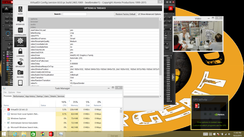

Ok so I added the icon and checked it and yes it says VDJ is using the Nvidia card but VDJ says it isn't,
And I changed the memory to "Automatic" and when I reopened it it says "Automatic (24)". The reason I want the Nvidia card to be used is because it has 2 gigs of its own ram and I always thought it would be better to use that then use the Intel card and share the system ram??

Of course the performance of the nVidia will be better, and if the task bar icon says it's using it then vdj is indeed using it.
You could check for an update on the intel graphics driver, it's possible that that influences the name you see in vdj.
Unless you need 60Hz output, use gpu-heavy video effects or have a relatively old generation cpu, chances are that the on-board gpu is already fast enough to keep a constant 30 fps mixing full hd video's.

Ok well I just updated the Intel graphics card driver and VDJ still says Im using the Intel card but in the Nvidia desktop thing shows VDJ is using it.
Ok so my next question is, is VDJ using the system ram or the Nvidia cards ram because it has a 2 gig card but VDJ says "Automatic (24)"??

If the nVidia is used it should go into video memory.
The detection of the amount of memory is currently not perfect yet for systems that switch between internal and discrete gpu, however that should practically not be much of a problem.
