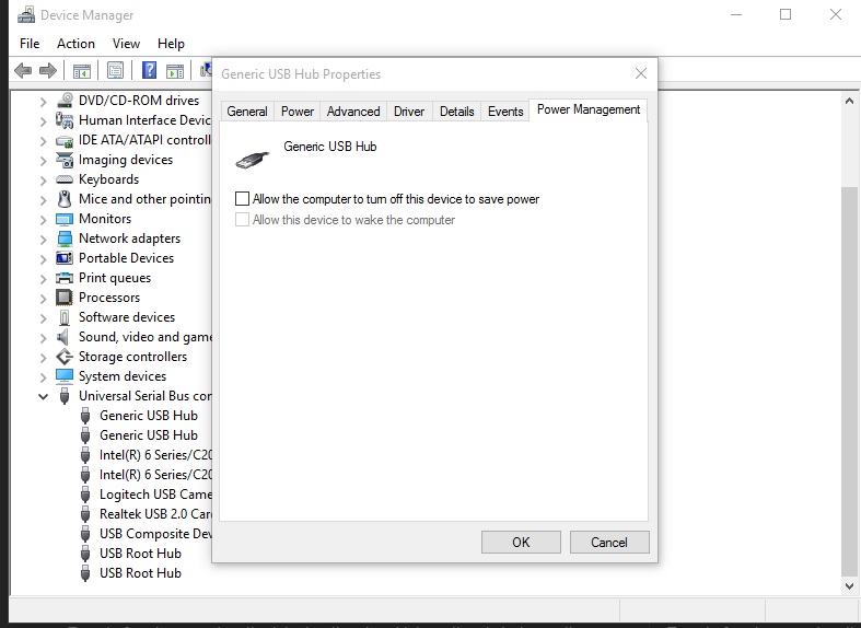

Device manager, universal serial bus controllers. right click on the usb hubs and go to properties, then power management and untick- allow computer to turn off this device to save power

I tried that but it didnt help. However I identified that problem appear only on 2 USB ports from total 4 usb ports on my computer so on 2 USB porets VDJ occasionaly feeze when track load from USB on other 2 ports its fine.. If I place USB stick to other USB ports, there is one second delay before VDJ load track but VDJ dont freeze. What it can be ?
