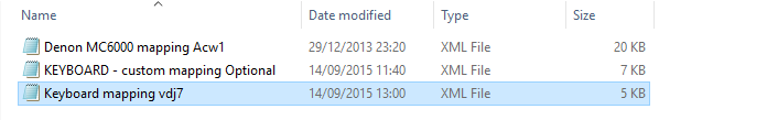

ok i have removed vdj 8 and removed all files in mapper folder leaving only a denon mc6000 Acw1 file and a keyboard map.
This is <mapper device="KEYBOARD" author="Atomix Productions" description="Keyboard" version="741" date="14/09/2015" priority="-50">
and i now have my vdj7 working as it was with shortcuts.
I have now installed vdj8 on my home (not DJ pc for testing this) and copied the mapper folder so it is identical. Home pc now has vdj7 mapped ok but not vdj8.
where from here? If i open vdj8 underr mapping it shows option for "ignore, factory default default,factory default optional, keyboard(think this is the one set for vdj7) custom mapping optional, custom mapping optional (1) NONE are in the mapper folder except the one i labeled Keyboard mapping vdj7
I think i need to use this custom mapping optional otherwise it looks to be writing to my keyboard one set for vdj7

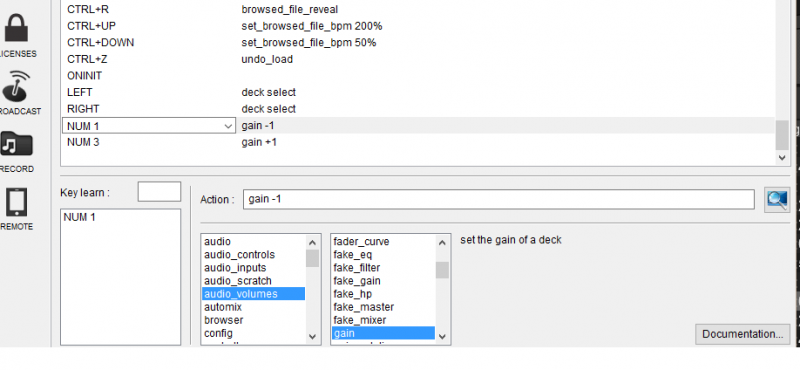

Home pc i seem to have both vdj 7 and 8 keyboard shortcuts set, but if i copy these files or even try to replicate using laptop keyboard, for some reason i can't get the gains set on two keys for gain +1 and gain -1 even though mapping shows these keys are set? ONLY in VDJ8
image of home pc (working) but settings same on laptop
Basically all i,m after is setting two keyboard shortcuts for the gains to increase/decrease on both decks as i had in vdj7
ON main home PC this works fine in vdj8 Windows 10
<map value="NUM 1" action="gain -1" />
<map value="NUM 3" action="gain +1" />
On laptop it has (does not work) Windows 8.1
<map action="gain -1" value="NUM 1"/>
<map action="gain +1" value="NUM 3"/>

what I did was made separate folder.
mappers v7
mappers v8
Whatever version I decided to run, I rename the right folder to "mappers"

Ok, removed VDJ7 and deleted all files in mapper folder.
Set mapping in VDJ8 for my NUM1 gain -1 and NUM 3 gain +1
But still it does not function on my laptop ( did in VDJ7 and does on home desktop pc vdj8)
Is this a bug , just can't work out why those keys won't map in vdj8 on my laptop
