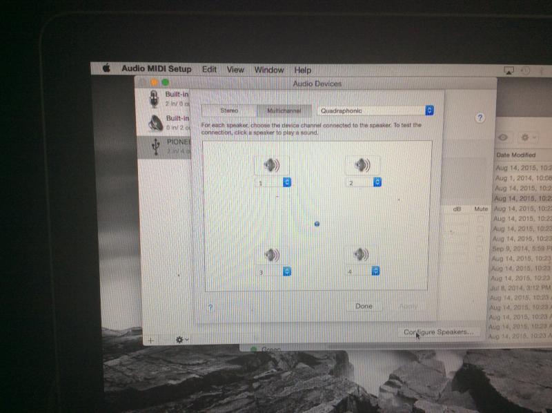

From Appliacations-->Utilities-->Audio Setup , select the built-in sound card of your computer as default and NOT the DDJ-SR
From the same Audio Setup , make sure the DDJ-SR is set to Quadrophonic (4 Speakers)

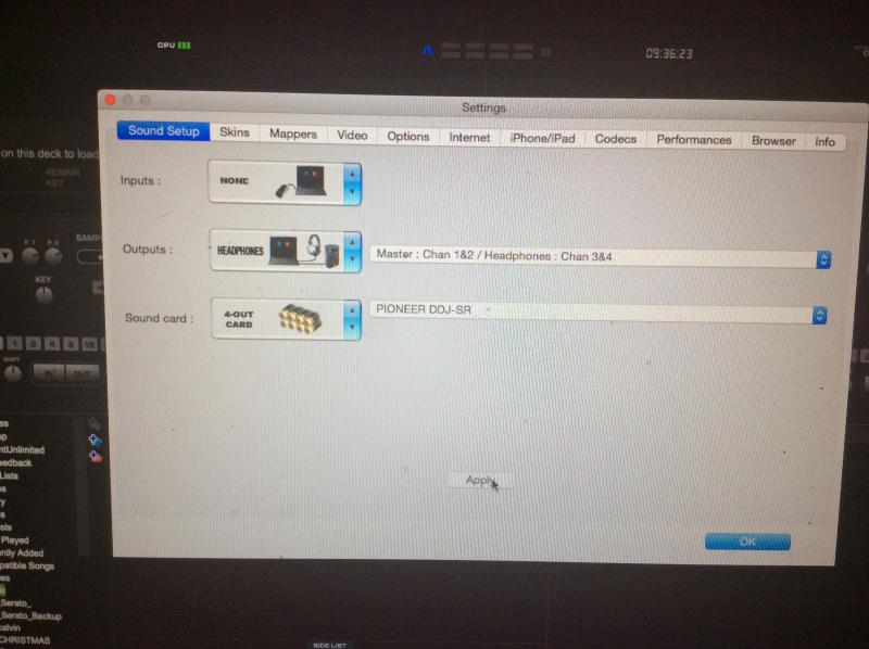

In VirtualDJ Sound Setup , use the 4out option and from the menu, choose the Pioneer DDJ-SR

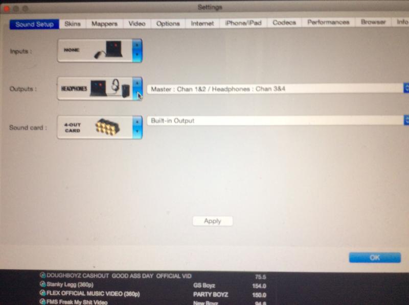

Is this correct
Posted Thu 17 Sep 15 @ 1:34 pm
Posted Thu 17 Sep 15 @ 1:36 pm
Yes, that should be correct.
