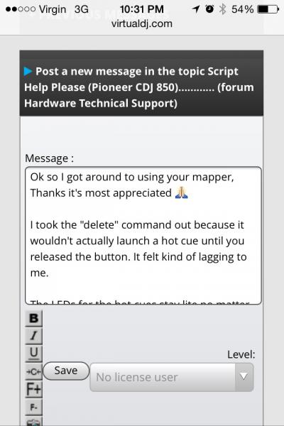

Why is this not showing my whole post?? Here's a screen shot of what is supposed to look like,
Typing from my iPhone if that makes a difference??

I assume it cuts the text after the little emoji because the character equivalent for that pic has some chars that get removed by the websites texteditor.
