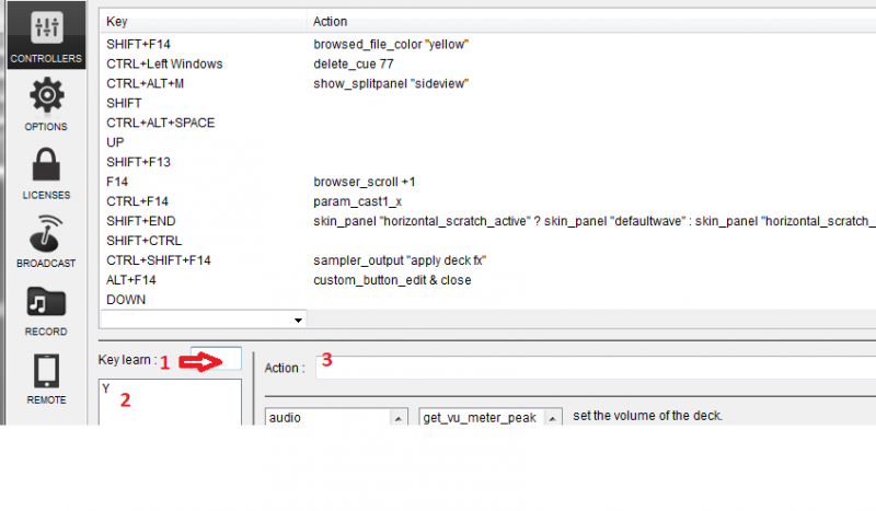

Go into mapping
Click the key learn box (1)
Enter a key
Pick the entered Key (2)
Add the action/script (3)
