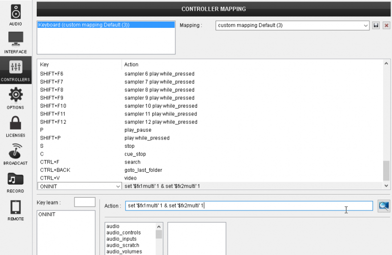

You need to add the following script to the ONINIT key of your keyboard or controller mapping...
set '$fx1multi' 1 & set '$fx2multi' 1

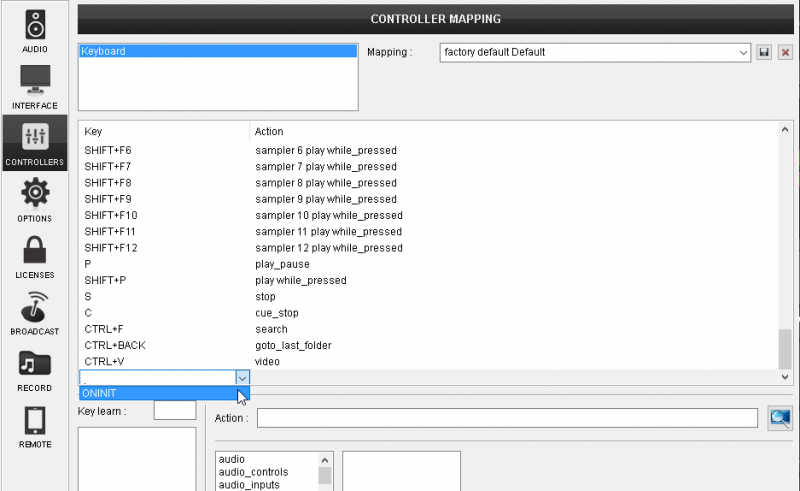

Step 1.
Once keyboard is selected (and the mapping file you are using - if the default is not the one), scroll down to the bottom and add the ONINIT key ..
Step 2.
Write in the Action box the script i gave you in my previous post.
