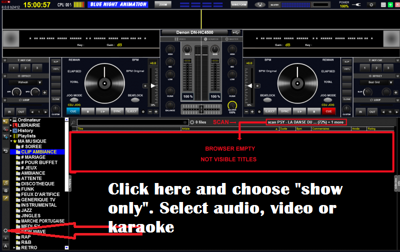

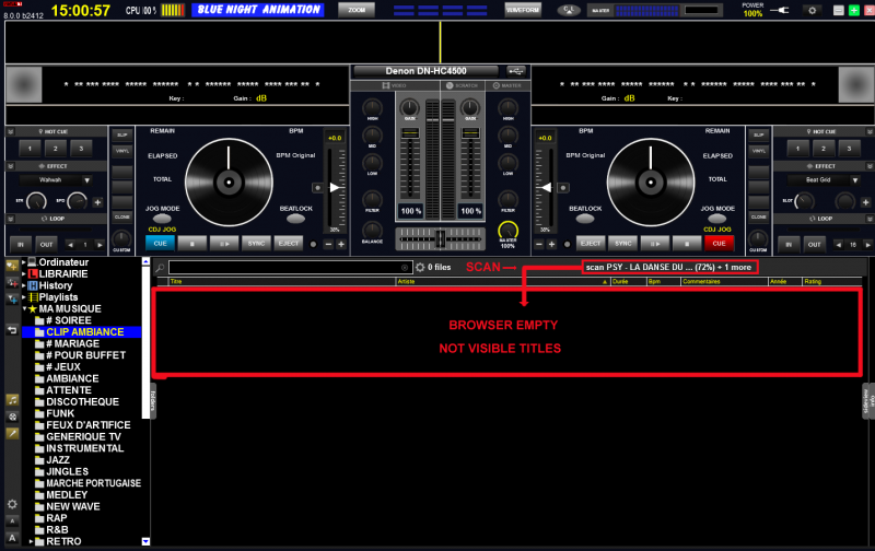

Hello (Google translation) Problem with VDJ8 B2378 video if an external hard drive Virtual DJ creates a directory inside it creates a data at an upcoming opening VDJ8 any video title appears in the browser, you must delete the directory VDJ the external drive.

Hello
Here is the problem :
Posted Mon 17 Aug 15 @ 1:27 pm

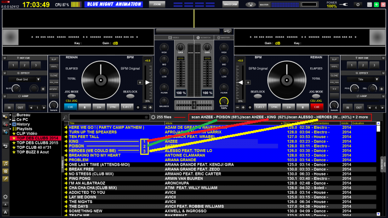

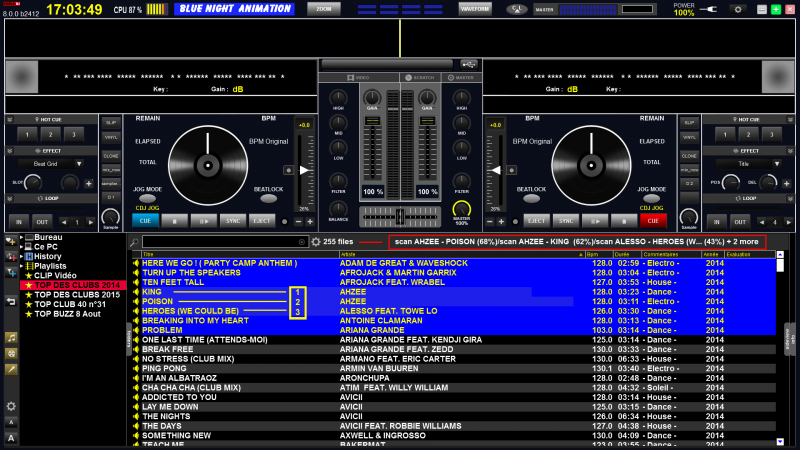

Another question: on my computer scan is done only on one line and apparenment possible on three lines. What to do?

Yet on my desktop that I use to prepare my evening it works on three lines.
Posted Mon 17 Aug 15 @ 3:17 pm
Ok, I can see that there are 3 progressbars indicating the scan.
But either this is a new feature, or I don't know what is happening here.

New builds (2389+) can do multithreaded scanning where possible.

OK SBDJ - on my desktop it works on three but on the animation only one, yet I am with V8.0.0 on both b2412.

Yes, but on one computer while on the second there is only one line at a time.
