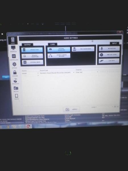

Can you post a screenshot of the AUDIO tab of your Settings when the controller is plugged ?

Yeah DJDad I Can Post A Picture On Here In About One Hour, I'm Still At Work And My Phone Is At Home.
