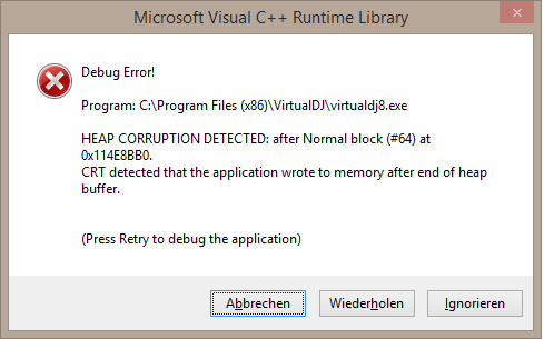

Finally I had some time to start playing around with the plugin SDK...
I did the tutorial and created a basic plugin.
All the plugin does at the moment is starting deck 1.
This is what I added to the tutorial MyPlugin8.cpp
At OnLoad()
At OnParameter(int id)
The plugin loads OK and I can start a deck, but everytime after using the plugin and trying to close VDJ I get this message.
What am I doing wrong?

The error will be in your code. If you post the full thing it would be helpful.
In commenting example lines in the SDK can cause you major problems. Leave those files alone unless you have good reason :)

Okay, here is the whole code of MyPlugin8.cpp
You see it is nothing more than described here
http://virtualdj.com/wiki/Plugins_SDKv8_Example.html
+ the additional code I posted above.

It's a stupid question but i prefer to ask it. have you merged .h and .cpp files in the same file or is it just a copy paste error?
Which version of Visual C++ ou Visual Studio are you using? Same question for the Windows SDK?
Do you compile in 32 bit? unicode?
Posted Tue 11 Aug 15 @ 8:08 pm
Oh stupid me... It seems that is indeed a copy&paste error.
Yes, as it is now, .h and .cpp are merged.
Although a dedicated .h with the correct content exists.
I'll clean the .cpp and report back.
I'm using VS2012 ultimate at the moment.
Windows SDK version? I don't know. Where and how can I check that?
32 bit, yes.
Unicode, I think yes, but have to check.
I'm using the default values VS creates for an empty Win32 C++ project.
I haven't changed anything here, except the output path for the .DLL.

Just a feedback, deleting the header file code from .cpp fixed the "problem" with heap corruption.
So, thanks for the hint. I sat there for an hour staring at my code and really didn't recognize I did such a simple and stupid mistake...
