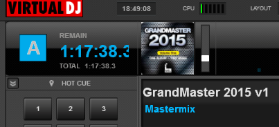

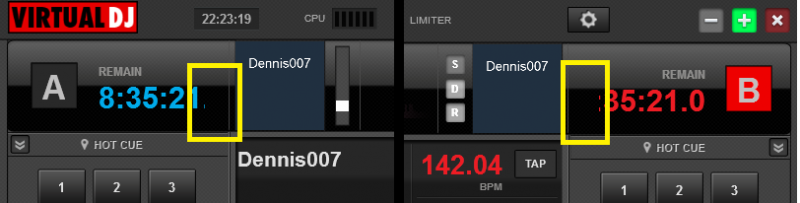

At long mix tracks the numbers cannot be read, because the text box is too small.
It seems to be a problem in the default skin:

Hi Jon,
yes, it would be fine if you could fix that for me, but in general the VDJ8 default skin should be fixed by the VDJ developers.
I use the 2 decks display in 1920 x 1080 resolution.
Regards
Axel
Regards
Axel

I can see the same issue too. (but its only cosmetic)
Ive updated to the latest version of the default skin and loaded a very long track, and as you can see the number is drawn too big..
but its only a cosmetic issue and its easily fixable with a quick edit of the .xml file...

Hi,
it is better with the Skin from DjDad, but there would be enough space to make the text box a little larger...
