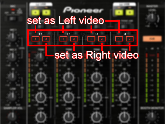

1)
$FX1 is just a name for a variable. A variable is used to check if e.g. a Shift Button is pressed. If Shift is pressed, the $shift-Variable would be 1, if not pressed it would be 0.
In your case, it is just a coincidence that there is a button with the name FX1 and a variable $FX1. That might be a bit confusing. But the $FX1 could also be named $mySuperSpecialVariable. It's just a name.
Your script, as above, does only set the variable $FX1 to a value of 1,2,3 or 4 depending on which button was pressed. Nothing more.
To achive what you want it should only be this:
Go to config - controllers and select your SZ mapping.
Click on Key Learn, now press one of the [1] buttons.
Klick on the name of the button, I assume it is FX1, and delete the Action right next to the button name.
Replace it with:
leftvideo
if that doesn't work, try this on:
action_deck 1 ? deck 1 leftvideo : action_deck 2 ? deck 2 leftvideo : action_deck 3 ? deck 3 leftvideo : action_deck 4 ? deck 4 leftvideo : nothing
Do the same for the [2] button and try this:
rightvideo
or this on:
action_deck 1 ? deck 1 rightvideo: action_deck 2 ? deck 2 rightvideo : action_deck 3 ? deck 3 rightvideo : action_deck 4 ? deck 4 rightvideo : nothing

Thanks a lot PachN,
thanks to your explanation, I managed to configure the buttons in the right way.
If someone wants to set the effects selection buttons on each channel as a left and right video selector on the PIONEER DDJ-SZ , here are the scripts:
For the LEFT VIDEO, you must put on FX1_ASSIGN the following script:
For the RIGHT VIDEO you must put on FX2_ASSIGN the following script:

action_deck 1 ? var_equal '$lv' 1 ? on & leftvideo auto & set '$lv' 0 : off & deck 1 leftvideo & set '$lv' 1 : action_deck 2 ? var_equal '$lv' 2 ? on & leftvideo auto & set '$lv' 0 : off & deck 2 leftvideo & set '$lv' 2 : action_deck 3 ? var_equal '$lv' 3 ? on & leftvideo auto & set '$lv' 0 : off & deck 3 leftvideo & set '$lv' 3 : action_deck 4 ? var_equal '$lv' 4 ? on & leftvideo auto & set '$lv' 0 : off & deck 4 leftvideo & set '$lv' 4 : on & set '$lv' 0
Brunoliv wrote :
action_deck 1 ? var_equal '$rv' 1 ? on & rightvideo auto & set '$rv' 0 : off & deck 1 rightvideo & set '$rv' 1 : action_deck 2 ? var_equal '$rv' 2 ? on & rightvideo auto & set '$rv' 0 : off & deck 2 rightvideo & set '$rv' 2 : action_deck 3 ? var_equal '$rv' 3 ? on & rightvideo auto & set '$rv' 0 : off & deck 3 rightvideo & set '$rv' 3 : action_deck 4 ? var_equal '$rv' 4 ? on & rightvideo auto & set '$rv' 0 : off & deck 4 rightvideo & set '$rv' 4 : on & set '$rv' 0

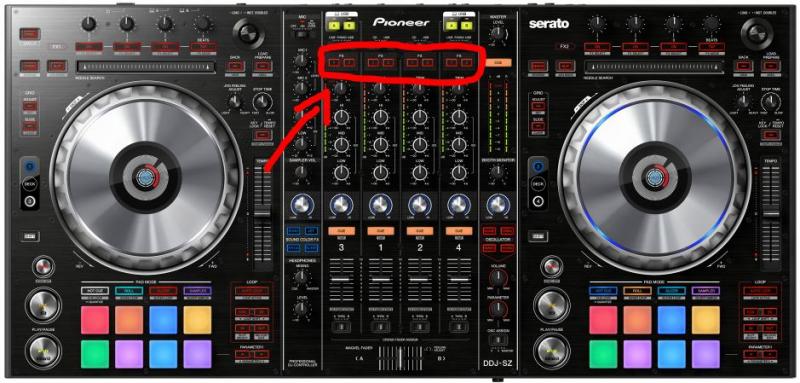

No, because there is only TWO key in the mapper. FX1_ASSIGN and FX2_ASSIGN for 8 buttons and because that VDJ needs to know in wich deck the button was pressed.
trust me, I tried to put only leftvideo, it doesnt work.
if look at this image of DDJ-SZ:
the area in red has 8 buttons, but only 2 entries in the mapper. no matter which button you press, the controller tells to VDJ that was FX1_ASSIGN or FX2_ASSIGN then you need a script a bit more complicated to differentiate the decks
Posted Tue 11 Aug 15 @ 3:58 am
FX1_ASSIGN mapped as : leftvideo
FX2_ASSIGN mapped as : rightvideo
should work.
Having them mapped as above, simply means that each deck can be leftvideo or rightvideo
So if you press the FX1 of deck 3, it will make deck 3 to be leftvideo and if you press the FX2 of deck 4, deck 4 will become rightvideo
I really dont see why this doesnt work for you.
If the scripts you came up with, work for you, keep them. Just need topoint others to a much easier direction in case someone needs to use those buttons in a same way.

Jesus.... it works hahahahahaha you're absolutely right! I tried it once and did not work because I had written DECK 1 LEFTVIDEO, so I thought I needed a code more complicated code to operate hahahahahah I'm feeling an idiot for not having tried to put only leftvideo and rightvideo.
But at least I learned a little more about Macros and also learned to think simpler before attempting complex things
