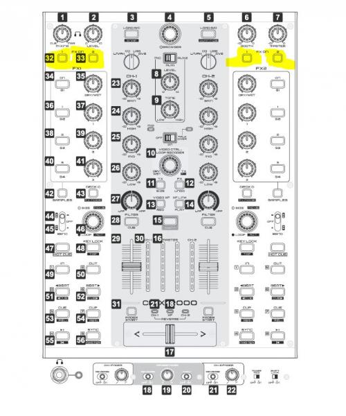

im sitting here with the CMX-2000 and i'm wondering about the mapping that is shipped with VDJ8, it seems not to work correctly.
The browser button works only with FX, which it should not and the two load buttons seem to be mapped for the same function.
Anyone have working Mapping?
Greetings, Jan

Indeed, some Keys such as BROWSE and LOAD seem that still carry some deprecated version 7 actions. Will be fixed and let you know.

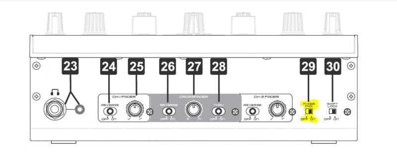

The Mixer has a small switch on the front side to make nearly all knobs and sliders from the mixer section midi capable.
You can turn it on to mix inside VDJ (e.g. volume slider oder gain) or just turn it off to use the own audio routing from the mixer. So also the booth volume knob works only for the video transistion when "Mixer Midi" is on.

I can switch between Midi and normal audio routing on the mixer on the fly.
When the mixer section has turned on the midi signal, all essential knobs and faders (e.g. deck 1 volume, EQs, gain etc...) has to work like a normal analog mixer.
Okay, i just got your post while reading it for the 2nd time (sorry for my bad englisch):
When the the "Mixer Midi" setting is set to "on" all knobs "lose" their analogue behaviour but keep their actual value and can be used as MIDI input - even the master volume.
For Example it is possible to use the master volume knob for another feature.
But this makes no sense, when i switch back to "off" it reads the new value of the knob and so i could easily blow any speaker or pa.
This means that the internal audio routing of this mixer must be fully digital.

So therefore it would be great if you could seperate the FX ON 1 and 2 buttons per deck. so we could have 2 more dedicated buttons (4 if you count the switch action too).
At the moment they FX ON 1 on the left and right side do exactly the same. Same for FX On 2 on left and right side.
As i saw in the VDJ 7 device xml file the buttons and led are not the same, so they could be mapped for different actions. It's quite simple to do but i can't change this in the VDJ8 because there is no device.xml to edit.

We always define the keys with the same name on both sides and the assigned deck in the definition instead of the mapping file , so that you can assign them with the same action (without defining the deck) and no need to do this twice (one for each side)
If you need to assign a button to trigger a different action depending on the side,you need to map it like this..
device_side 'left' ? actioWhenTheLeftButtonIIsTrigered : ActionWhenTheRigthButtonIsTriggered
or
action_deck 1 ? actioWhenTheDeck1ButtonIIsTrigered : action_deck 2 ? ActionWhenTheDeck2ButtonIsTriggered : action_deck 3 ? actioWhenTheDeck3ButtonIIsTrigered : ActionWhenTheDeck4ButtonIsTriggered
