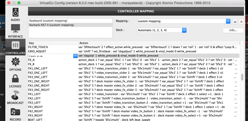

Hi djdad,
Thanks for your prompt response.
I am using an NS7II controller and the actions are as shown below.
Where should fix that piece of code? Many thanks...

Help me to help you ;)
which button of the NS7II do you wish to work like this ?
please declare it by its Key name of the mapping or the name that has on the silkscreen on the unit
Is it only one specific Effect that you wish to enable a specific Video Effect (like the example above) ?
Do you wish this behavior to apply on all 3 Slots of the Multi FX mode ?
Posted Wed 10 Jun 15 @ 7:36 pm
I would like this behaviour on all 3 slots of the Multi FX mode. FX1, FX2 and FX3
When the effect is active, I would like the 'Spectral' video effect. Let me know if that makes sense?
Many thanks.
Many thanks.
Posted Thu 11 Jun 15 @ 8:39 am
