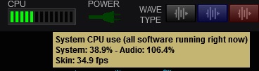

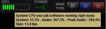

I'm trying to push my system to find out what's happening. Why it crashes.
I noticed that after playing a song, and both decks stopped, and have sound FX active (reverb, echo, flanger and phaser) on the audio cpu usage goes up sometimes beyond 100%.
Both times these crashes occoured while not playing any song.
As long as both tracks play the audio cpu usage goes down to very low numbers.
It seems somehow, also the CPU usage goes up when no audio is playing.
I took some screenshots when these odd behaviour happened showing VDJ and task manager and resource monitor if it's any help.
Posted Mon 11 May 15 @ 1:03 pm
Tried it on my other PC. Same thing, even worse:
It has something to do with FX being turned on when no audio is playing.

It seems that Reverb and Phaser adds most to the "Audio" reading of CPU usage.
