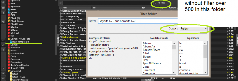

You could easily create filter folder that is nested inside the folder your are currently using.
If a filter folder is nested, the editing window for the filter folder will show an additional drop down field named "scope".
Set the scrop to "folder" and use this action:
bpmdiff<=2 and keydiff=0

So you created a new filter folder and nested it into the folder you want to filter?
Should look like this
Posted Tue 12 May 15 @ 11:58 am
