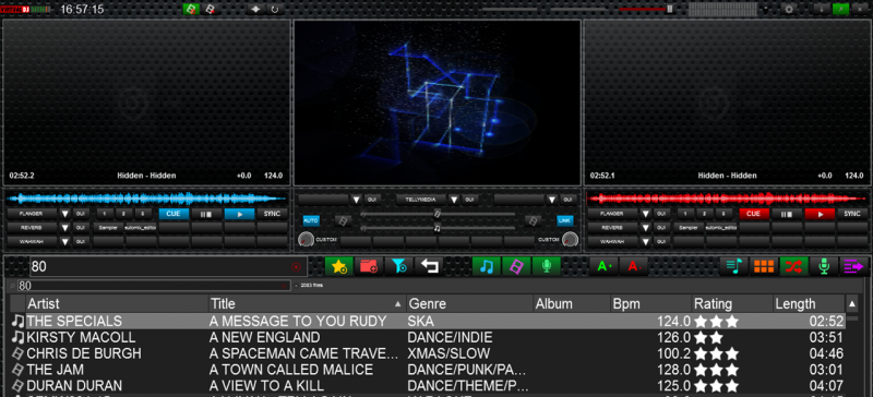

Will we ever get an answer to this question... are you going to fix this or not? Blank monitor screens on left and right deck when playing audio only files.

It's due to the way the effect system works - the audio only visualisation is a plugin, and that plugin is active on the master deck at that time. Because it's not active on the other decks, it's not visible.
You could always change the skin so that if the audio only visualisation is active on the master (ie neither left not right decks have video) then both deck video displays switch to display the master too, thus giving you no blank spaces.

I suspect you'll need to wrap the deck video displays into panels, duplicate the panel with a master video display and then set the visibility of the relevant panels according to whether a video is loaded on both left and right decks.
So at the moment, you'll have something like
Which would then have to be changed to something like:
The visibility scripts may need some tweaks, I haven't actually tested them. Worth speaking to Dan to see if he can help you out with this I think.
<video x="+0" y="+0" source="channel" chan="left">
<size width="110" height="61"/>
</video>
<panel name="leftpreview" visibility="deck left is_video ? on : deck right is_video ? on : off">
<video x="+0" y="+0" source="master">
</video>
</panel>
<panel name="leftmaster" visibility="deck left is_video ? off : deck right is_video ? off : on">
</video>
</panel>

I'll have a look. It's easy enough to do as have implemented in my new skin that I never seem to have time to finish.
I'll add some code and rid you of blank screens.
