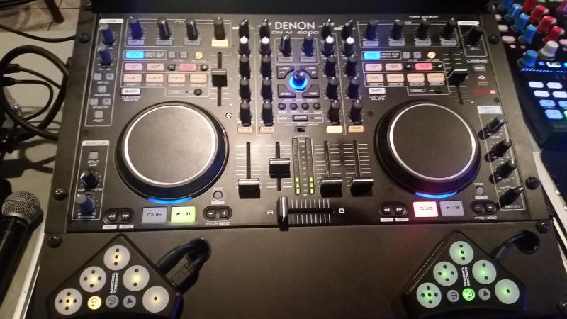

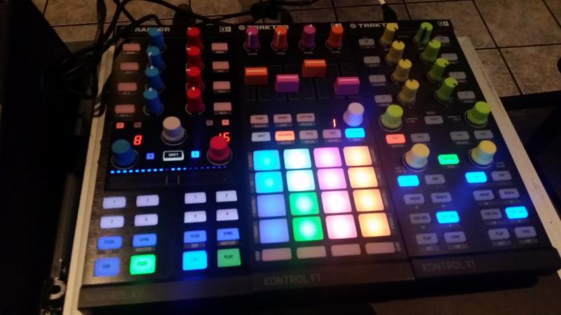

MC6000, Dicers, X1mk2 for loops and effects. F1, and X1 for video effects and transitions. See photos.
Invisible decks? Explain...
