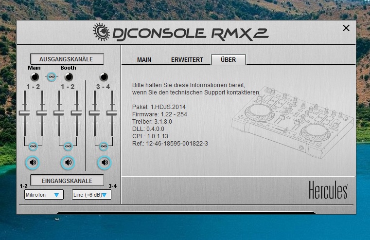

Can you detail the information you have in the ABOUT tab of the Rmx2 control panel ?
Posted Tue 28 Apr 15 @ 10:20 am
A screenshot is better as thousand words...
Posted Tue 28 Apr 15 @ 10:25 am
Indeed it is.

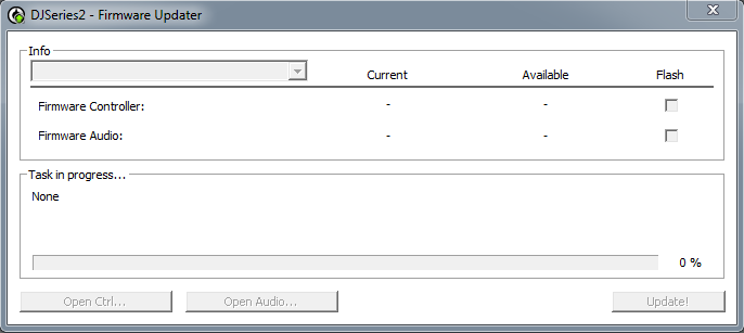

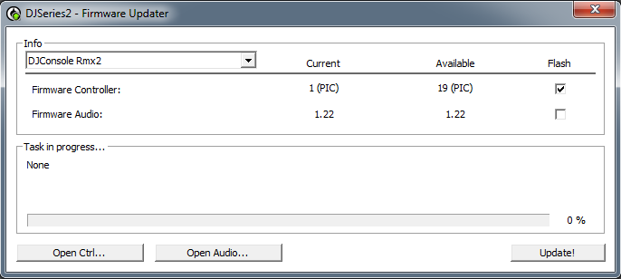

Strange. At least we know the console is actually in Boot mode when these buttons light up, so we'll have to proceed manually.
- from the Run menu, enter the following command (including quotes):
"C:\Program Files\Hercules\Audio\DJ Console Series\cpl2\firmware\HDJSeries2Updater.exe" –manual
- The manual updater should pop up:
- Turn on the Rmx2 as indicated previously to set it in Boot mode. This is what you should see now:
If this is all correct, click on Update! to launch the update process.
If however you see something different, please post an image.
Posted Wed 29 Apr 15 @ 7:57 am
First off all i must thank you mate for all your tries to help me, i did all you say but now i got an error as you seen on the picture below...
Posted Wed 29 Apr 15 @ 3:24 pm

It ain't over till the fat lady sings...
With the Firmware updater open, if you connect the Rmx2 normally (without holding the buttons), what do you get ?
Is it possible to perform the Firmware update from this state ?
Posted Thu 30 Apr 15 @ 8:55 am
