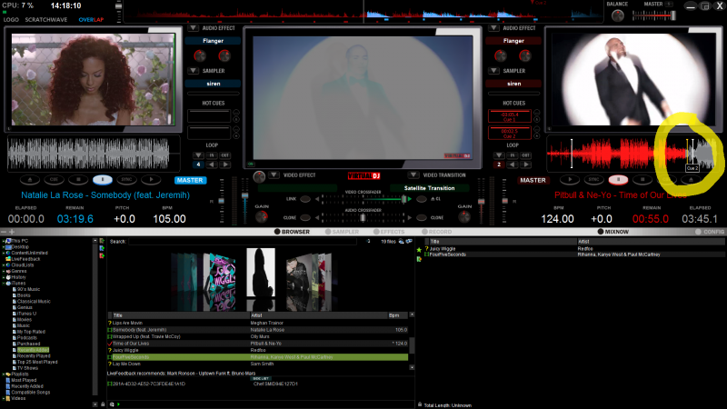

ive been using virtual dj pro 7 for a few years now. when we do wedding and bar events more and more people are asking for the music videos on our screens. we have purchased a lot of videos but plenty of them have random talking scenes in the videos or other random unnecessary crap. it there any way to cut out part of a song, without setting a cue stop and ending the song entirely
for example the part i circled can i cut the part between cue 2 and cue 3 there?

You can with V7 you need the CueMacro plugin.
You'll have to read up on the plugin - Here
At the point of the "break" set a cue 10, at the end of the break set a cue 11, rename cue 10 to precisely this (` included)
cue 10 `hotcue 11`
The plugin monitors cue 10 and when it gets there performs the action inside the ` `s
But Rob is right V8 is much much easier.
Btw the track cleaner can cut video too.
cue 10 `hotcue 11`
