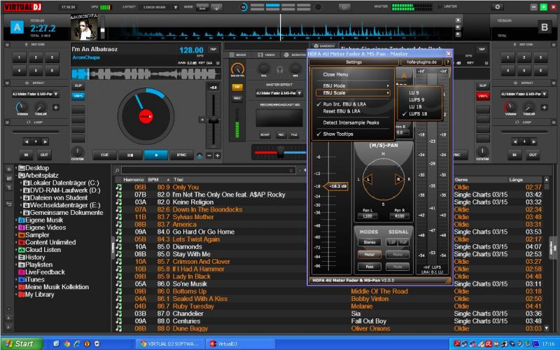

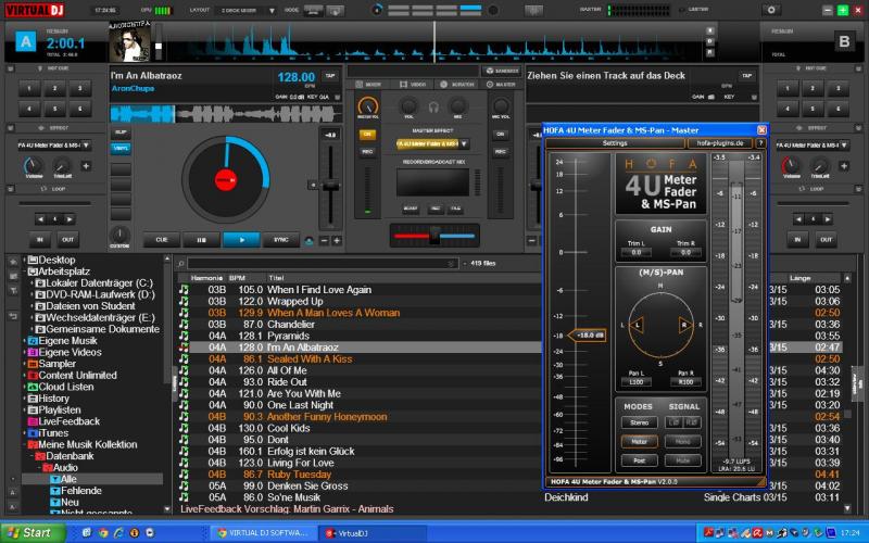

Eventually you can use the Hofa 4 U vst plugin,as Mastereffect in VDJ 8
this works with EBU 128,but have self this not tested on my PA,but in VDJ 8 this works.
Im searching,looking and read more over the EBU 128 Norm,eventually i will do this too.
But all this is Newland for me.
http://www.kvraudio.com/product/hofa-4u-meter-fader-and-ms-pan-by-hofa-plugins
greetings,Dirk
greetings,Dirk

I haven't tested it, but it doesn't look like it does any limiting, so I think it is either just a -18dB volume (and in this case any volume over 0dB at the input of the plugin will still come out louder than -18dB at the output), or it clips the output at -18dB, in which case you would get clipping artifacts. I would personally prefer a limiter in that case.
