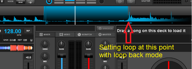

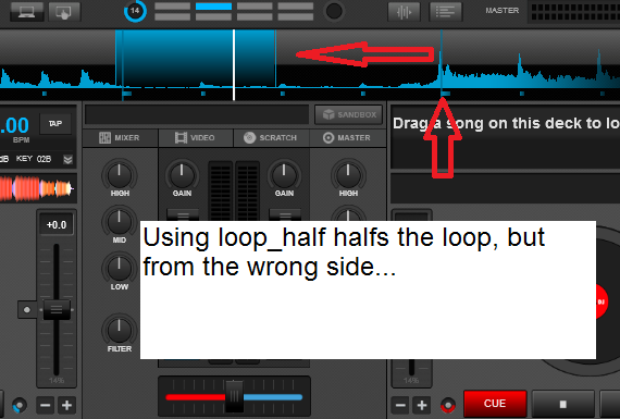

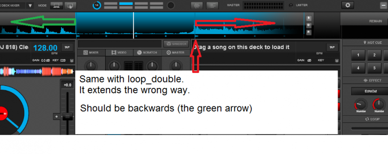

If you set the loop mode to back and use the action loop_half, the loop will get the half size, but from the wrong side.

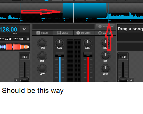

No its not weird.. Think of this:
You set a back loop just like in my image above just before the beat kicks in.
Now you are looping the last 4 Beats before the drop, half the loop so you get the last 2 beats just before the drop, then half it again to 1 beat, 1/2 Beat.... and then drop the bass...
That is only possible if the loop position - your end point of the loop - in loop back mode is not changing.
Just now, if you half the loop from 4 beats to 1 beat and then release the loop you have to wait 3 beats before the drop.
