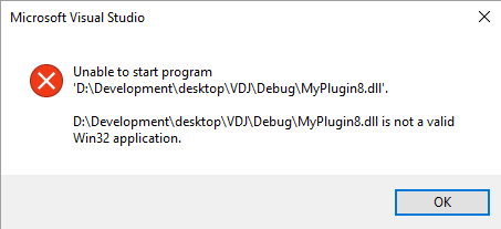

          Trying my hand at developing VDJ plugins.  I'm using Visual Studio 2015 express on Windows 10 box.   Was able to get DirectX9 installed-ish.  (enough to get past not being able to find the #include <d3dx9.h> file).
So everything compiles fine, except at the very end when it looks like it's gonna start, I get the following error message: Unable to start program... MyPlugin8.dll is not a valid Win32 application.

          Looks like I just needed to "attached to process..."??  Although now, the plugin shows, but crashes VDJ as soon as it's activated.  Thoughts?
    Posted Thu 09 Jun 16 @ 3:57 am
          Best bet is to set the debugger to run VDJ automatically - you can't run a dll. Then you can just hit run and it will all go :)
As for the crash it's likely to be a bug in your code.
