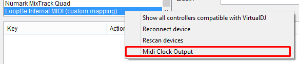

1. Install LoopBe1
2. Start or restart VirtualDJ
3. Settings -> Controller -> You should see "LoopBe Internal MIDI" in the device list.
Select it, rightclick and choose "Midi Clock Output".
Screenshot:
VirtualDJ will now give the master BPM to LoopBe.

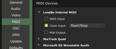

4. Open your software which should recieve the BPM signal or restart it (a re-scan is often not enough!)
5. Go to your MIDI settings and select LoopBe Internal MIDI as the MIDI Clock Input OR aktivate the MIDI Clock Input for LoopBe (e.g. Resolume).
Screenshot Resolume:
Done! As soon as you have a track running on the master VirtualDJ will send the BPM to your application via LoopBe =D
