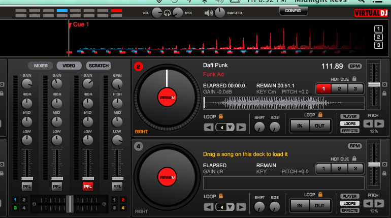

First of all, the Cue track is playing through the right main output (FOH) speakers. This shouldn't be here, it should only be in the headphones, but the cue volume knob is working correctly with this. Full left and the cue plays through the speakers (channel volume fader all the way down). The volume knob does not affect this volume, and when I turn it it won't turn in the VDJ software, although the cue knob turns in the software.

So, as you see the settings in the photo, no cue volume is playing in the headphones, but it is playing through the speakers.

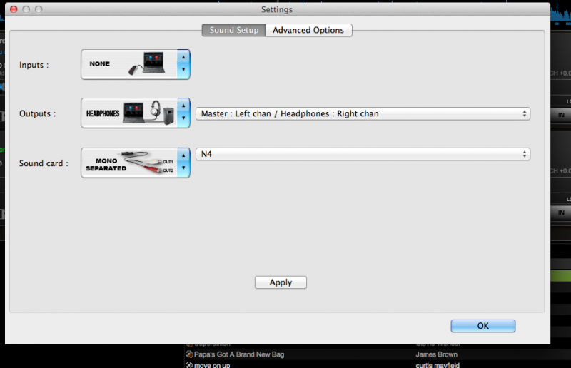

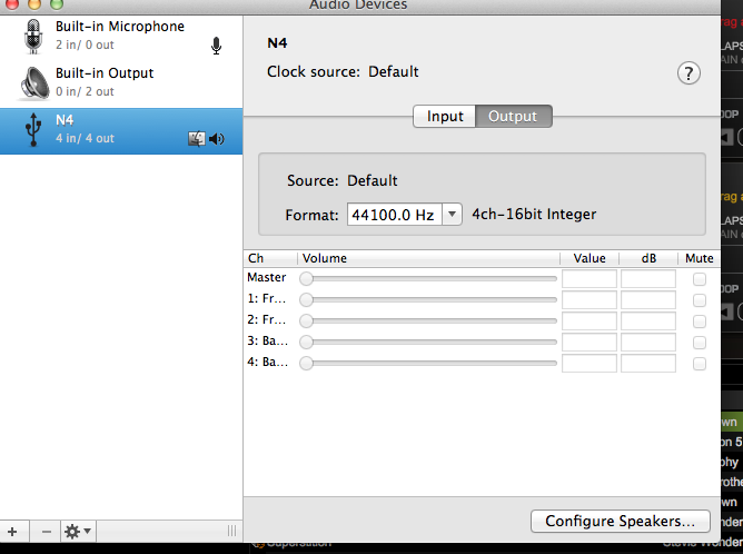

Here are some screen shots. It wasn't set to quadrophonic, but I changed it there. Each speaker works separately with the test, but the exact same problem persists.

Sorry, double posted a pic there, here is the one I meant to send

You have selected "mono separated". That is your problem.
You would usually only select that option if you had only one stereo output and needed to cue (in mono).
You need to select "4 out card".
