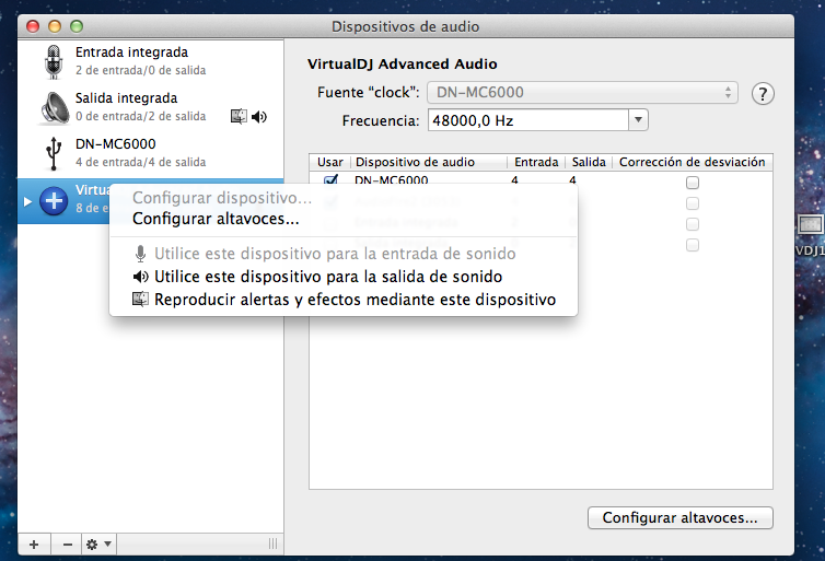

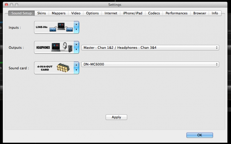

Post a screenshot of your sound settings
Posted Thu 05 Mar 15 @ 12:34 pm
Posted Thu 05 Mar 15 @ 3:33 pm

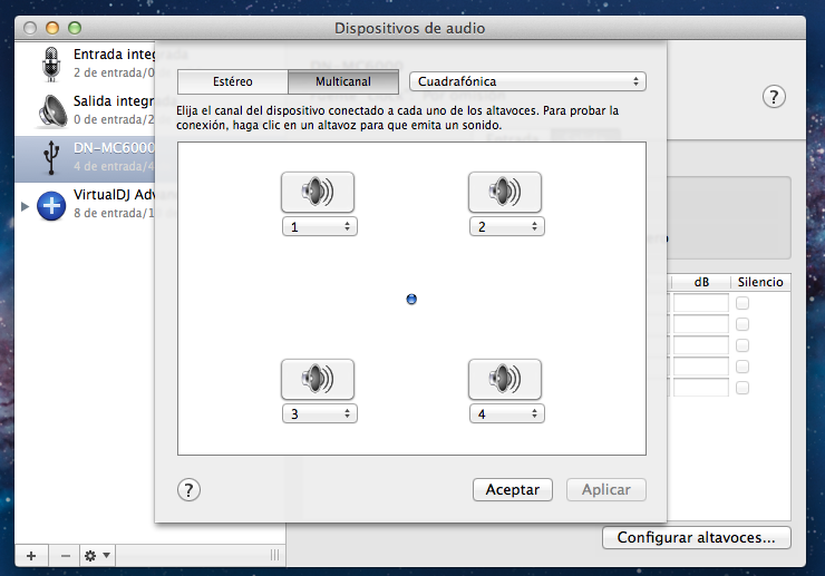

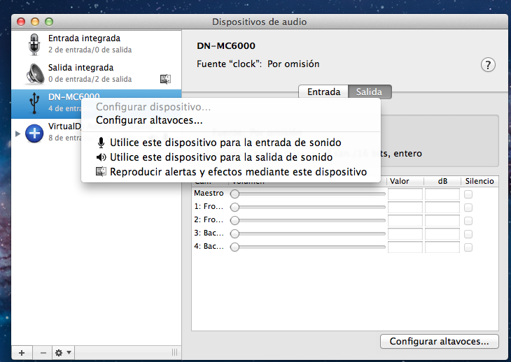

Have you set your card to quadraphonic speakers through audio/midi setup on MAC OS X ?
Posted Thu 05 Mar 15 @ 5:51 pm
I don't think so where I can I do it? If I go to system preference-- sound--- i don't find that option...
Many tks!
Many tks!
Posted Thu 05 Mar 15 @ 6:12 pm
Launchpad->Utilities->Audio/MIDI setup
Posted Fri 06 Mar 15 @ 12:57 am
Posted Fri 06 Mar 15 @ 5:22 am
apologies, some screens shots are duplicated!
Posted Fri 06 Mar 15 @ 5:24 am
