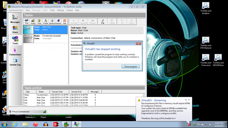

I've been trying to narrow down crashing with build 2162.945. I have not had issues like this in the past. However, I do use this laptop for other things. There is the possibility I have introduced a problem in the last few months without being aware. I do know that Jan 1st I ran the same plugins and equipment with no issues. I am using the Toshiba C855 listed in my profile with a NI Audio 6 and timecode. At the time of failure, timecode is calibrated, but not enable as I am running an automix playlist. I created a support ticket and the response was to open a thread.
After roughly 2 hours of playing, the system crashes. I am using Milkdrop, TellyMedia, and TellyVisuals plugins. I have purchased and introduced IMU the past few days. I was testing with the demo IMU and iWall in the past without issue. The playlist has a mix of video and audio. In the past I had videoForceFullscreen set to 1 because my video card seemed to perfome better, however, if video output was stopped, a restart of VDJ would be required to reenable it. I have now changed videoForceFullscreen to 0, I can disable and enable video at will. I experience more tearing, but it is usable. My main issue is that VDJ completely crashes. I do see a dump file in the user temp folder along with crashlog.exe. The dmp file is 0kb, I assume there is a debug level to set for more info.
Last night I had something new since I set fullscreen to 0.
While typing this, TellyMedia dropped off the display after running for about 1.5 hours. I recieved the same VDJ Streaming alert. It is possible I have narrowed in on the issue. Would the plugin crashing in videoforcedfull 1 bring down the whole program vs having just it crash and the alert?

Okay, so I got the streaming error again without TM active.
I have fully restarted the laptop. I did not start up IMU. I have VDJ running a mixed playlist in automix. Milkdrop is on as videoAudioOnlyVisualization
I will let that run and see how it does.

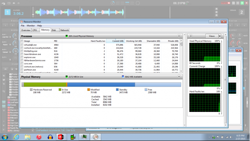

This time VDJ froze playing an MP3 2 hours into the list. I am using different lists and these issues are happing with different songs that have played in the past. I do not believe this to be a file issue.
I could not close VDJ even with the task manager and taskkill at a prompt. My PC would not shut down fully. I had to force power off.
I was able to use other aspects of the computer before that time. I did get a screen shot of the memory usage at the time, but not right when it locked up.
I now have a playlist running with no video turned on. Milkdrop was removed from the audio only selection (selection was set to none). Then I restarted VDJ, put in a new list, and I am running it with video disabled. I'll start at this step and progress from there.
EDIT: VDJ is running at 460,472kb with no video or plugins running.

An hour and a half in and TM crashed. Resource monitor showed the memory used by VDJ climbing over 3 gig and my available memory going down. I failed to save the screen shot of the resource monitor before shutting VDJ down and rebooting.
I re-ran the Intel fix tool as mentioned above. I will try running with just Milkdrop and see what happens.
EDIT: When a video is playing, VDJ uses around 1.5Gig. It drops after a transition and then climbs to there again, as I would expect. I have 2 Gig allocated for video memory in the options.
