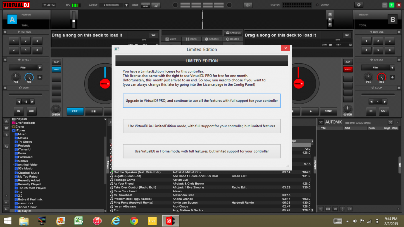

I have a Numark NS6 and recently bought a license for virtual DJ 8. It recognizes the controller on start up and I am able to play songs, but every once and a while there will be a click and the the audio will cut out. There will be about half a second of silence and then the song will pick up from where it stopped but the LEDs on the controller will freeze in place. When this happens the USB led on the controller will go out and when the music starts it will go back on. I've noticed that it usually happens when I'm searching for songs using the controller's file browser although it has done it when I'm not even touching the controller. My computer is fully up to date and I've re-installed both VDJ and the drivers for the NS6 but nothing has helped. This has been going on sense I got the new version of VDJ in mid January. Laity I have been getting pop ups when I open the program that tell me I have a limited addition of the program and need to upgrade. When I close out of that window and check my license I am logged in with my Virtual DJ account and it tells me that I still have the NS6 license. The pop up is not the big deal, the important parts are my audio and controller LEDs cutting out. Please help I have some gigs coming up and I could use a quick fix! by the way I'm running windows 8.1.
