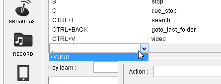

Oninit means "on initialization", and that means this method is called when VDJ is starting.
I think you can get it by pressing a random key and the open the dropdown field like shown in the pic above.
Posted Fri 06 Feb 15 @ 10:27 am
No, you cant get the ONINIT key in the Mapping tab with any key combination.
Its just an additional Key (not available/assigned by default) which you can get if you scroll down to the list of the Keys and click on the drop-down of the empty key.
